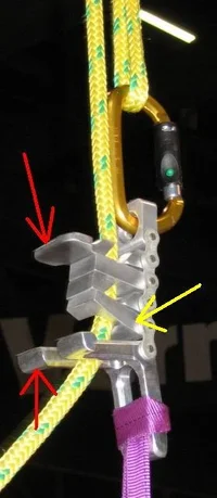

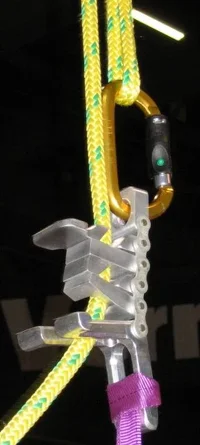

The plate that the yellow arros points to is spring loaded so the Uni doesn't slide like the LJ. Next time I climb I'll pay closer attention to this feature.
John,
To descend, the plates that the red arrows point to are pulled together. The action is very similar to the LJ. With a little practice I've gotten the feel for easing into a descent.
