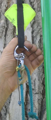

This is my trigger setup. I use a stainless snap shackle with the blue line laced through the eye. The friction hitch is made with some large diameter throwline. Make sure that the gate of the shackle opens away from the pole section so that it doesn't interfere with the pouch.
I've talked with some people who use arrow releases instead of the shackle. That seems like a good trigger since I've seen them for sale at around $15.
