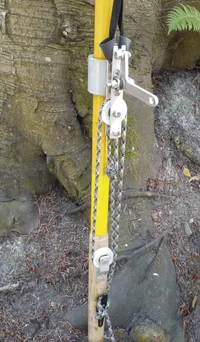

I found that ordinary 3/4 inch NPT sch. 40 aluminium pipe slides smoothly inside the usual size of our fibreglas poles, so I chopped up my Big Shot pole into chunks no longer than the Big Shot head and which all fit with it into a short carrying bag less than two feet long. Here is a photo. I have a DIY trigger and MA cocking mechanism also.

Could we see your trigger up close?

The short pieces of aluminium pipe did not add much weight at all. Here is a shot of the trigger up close. There are two ball bearing shivs for 3/8 inch rope, for a 3 to 1 tackle for cocking the Big Shot, with a trigger above the top shiv. I will try and get a photo of the rig put together and cocked.

Well, aside from simply being a hopeless tinkerer, I was concerned about being seen hiking on BLM or state park land carrying a giant 8-foot slingshot! This one now all fits in a 2-foot long green bag. I will try to get a photo or short video this weekend of the thing being cocked, to show the trigger I made.
Just took a photo of the Big Shot assembled and cocked, to show the trigger and cocking MA. You pull down on the aluminium lever to fire, either by hand or with a lanyard. I have enough of the short extensions for a total length of about 9 or 10 feet of pole if I need a really long shot.

@Burrapeg- How did you secure the 3/4 inch NPT sch. 40 aluminium pipe inside the fiberglass poles? Epoxy? I'm not seeing any through bolts.

5-minute epoxy. The fit is smooth but probably not tight enough to pull a pole saw. You would need some way to lock them that would not protrude and snag the rubber of the Big Shot.
