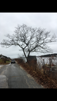

Real question though- can a bucket or lift park on that driveway and reach most of it?
Specs on the tree will help a lot.
Is that 18" dbh or 30"?
That wee truck is parked alongside it for scale. Road is single lane… Guessing crown spread ~70’, ~28” but spread matters more.
I wouldn’t reduce, maybe a little thinning just cause it would look cool.
I'm open to suggestions, what are your thoughts and bid? The client is having a new pier put in for $$$, the tree is touching the dock shed, bank is getting undercut beneath the tree from erosion etc etc
Can you drop brush in the water and leave it? J/k but that is my dream job haha.
The new pier should be done end of Jan and will make for easier brush clean up (still not easy tho). Bucket could setup there, we only climb.
