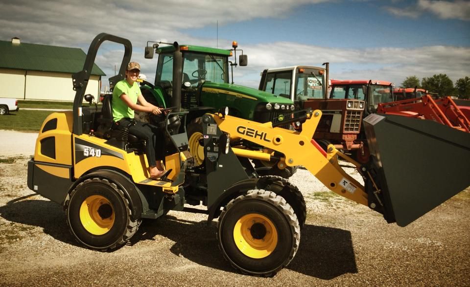

Drove a total of 10 hours today and bought an AL540. I'd never driven one before so I was a bit nervous about how it would feel. It was very intuitive. Took and spun some cookies on some grass without even a trace that I was there.
Waiting on Dave to make some more grapples. I'm very anxious to put this thing to use. I feel like this machine will set us apart from other companies in a great way.
Stay tuned for some good videos and photos of the thing in use.
Here's my girlfriend giving me final approval before purchase.
I haven't decided on the tires yet. Dave says these are the way to go. We will probably get some use out of them before making any decisions to upgrade to turf tires. I like the versatility of just using these so long as they remain turf friendly.
Will you put a grapple on it?

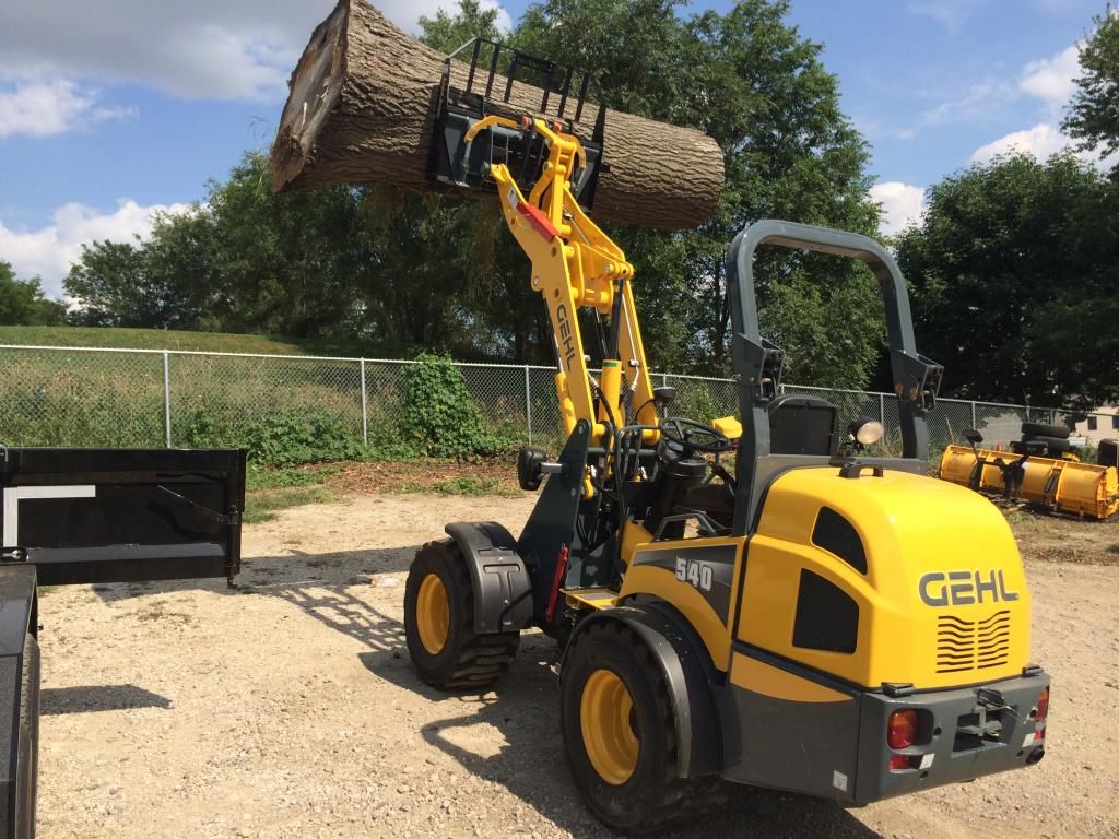

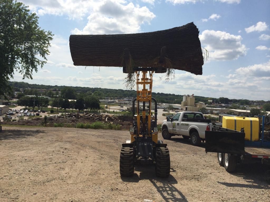

that is amazing. I never new a swing loader would have that mega lifting power. Now I know what I'm gonna get for my next loader. If I get another. Goddarn that's something.
