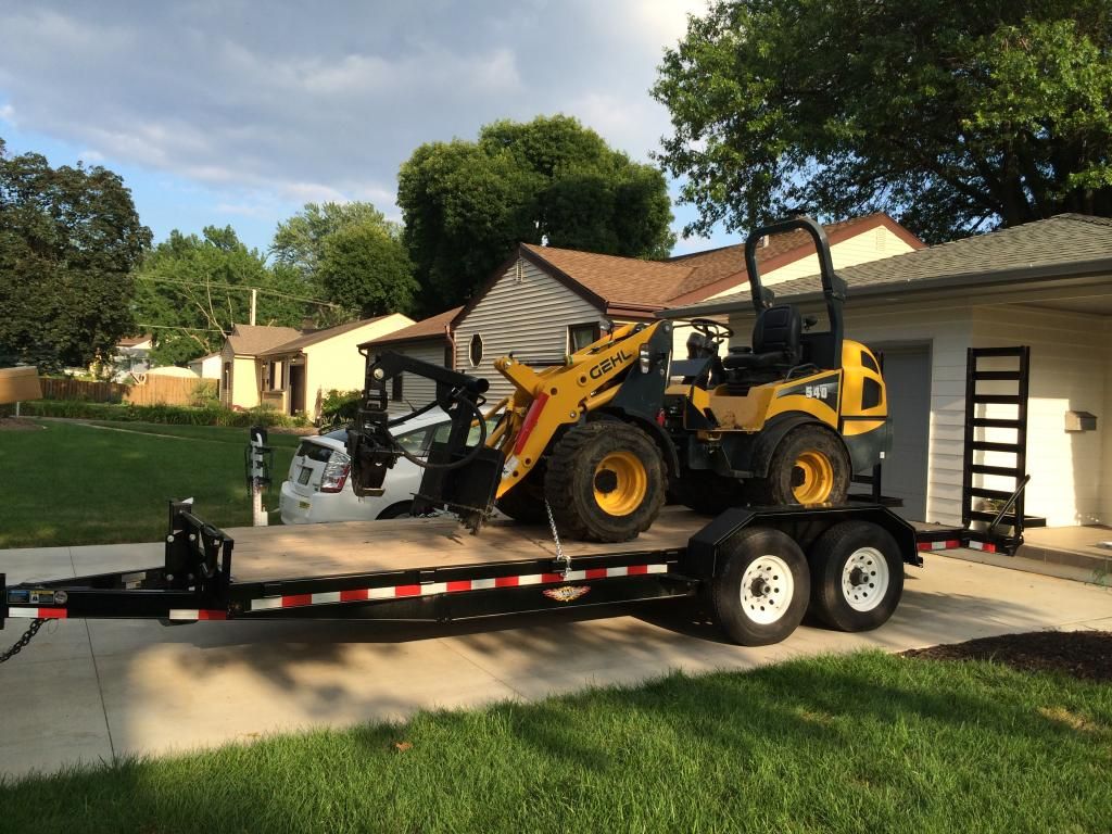

Machines working well so far. HD Grapple has a few kinks to work out though.
Pros:
  • It really does leave no trace on grass. Turf tires arent necessary on this machine. In fact I wouldn't recommend them.
  • I love the visibility versus a skid loader. I can back up long distances without wondering about whats going on behind me. This also helps with feeding the chipper.
  • Tons of power. Pulling over huge trees with backleans saves us half a day that it would have taken to piece the thing down. This savings is enormous.
  • More comfortable to ride on than a skid loader
  • Price- much cheaper than a comparable skid loader
Cons:
  • Headlight on the 2 post ROPS are probably going to get pulled off from branches. They sit near the boom and have been getting knocked around.
  • Seems a little tippy. I don't think I'll let any greenhorn hop on this machine. Its stable enough but don't lift boom high without being on flat ground. Maybe its normal to have the front opposite wheel come off the ground a bit but it makes my butthole pucker up.
  • Material handling bucket doesn't tip up very much so its hard to load stump grindings or other debris without being pushed into the bucket by the mini.
  • Harder to feed the chipper than the mini unless the brush is very long. Then it is relatively easy but takes quite a bit of room to maneuver it in there. The mini feels like an extension of your body as if you had robot arms. This machine is nice but a bit more clumsy.
  • I think it will be hard to convince people to let me drive it on their yards. Its an intimidatingly heavy looking machine. There will be some preconceived ideas of what their yard will look like after. I might have to come prepared with some video demonstrations.

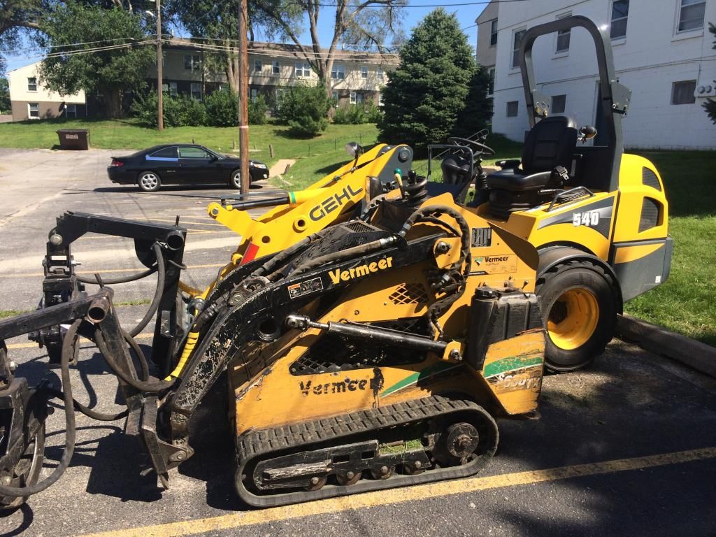

I had a BMG grapple on one of my mini's but did not like the free spinning grapple or the down and out front nature of it which reduced capacity some imo. The spinning made it hard to grab at times without getting off the machine. I sold it and the next guy did not like it either.
I don't see any piece, I couldn't lift with my BMG. In fact I am pretty sure I could carry almost double what the video shows. It is all in how you try to carry/move the piece...low and tight.
But maybe this is an bad example of what you are talking about.
Free spinning grapple is awesome for flowing turns. To turn the grapple, to grab something, you just have to learn how to tweak the mini...or use of the brush to spin it. Once you grab the brush you can lock the spin, or free spin depending how you hang the grapple.
Imo if you are using the grapple (like pic below) you are using it way wrong. It doesn't hang low, unless you let it...and most times you shouldn't.
I had a bmg grapple on one of my mini's and did not like the uncontrolled spin on the unit and how far out front it stuck out and how low it hung down.
I think it's what you get used to. I have a grapple bucket like you have treevet on my regular skid, and I believe when I get my mini i'd probably prefer that type on it as well, as opposed to the hanging kind. I've learned to work well with it. The only thing i think might be better with the bmg style is loading brush in the chipper. But once again, the guys who've been running the bmg all along probably think we're crazy. These things become an extension of our bodies so it's hard to break habits.
