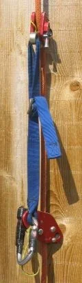

I like backing my petzl handled ascender with a Yates rocker. It works pretty smooth. I a separate webbing and biner with the rocker over the petzl.
I attach my Rocker low, to my saddle bridge. This seperates the two attachments. The chance of something happening to both of them when they're 20 plus inches apart is in my favor.
