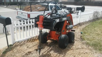

0401161424_resized.webp Here is another picture of the mounted grinder attachment:
So, the first grind was with an 8 inch aspen stump. The grinder actually cracked the stump prior to grinding, but then ground it out pretty good. My calculations of chips at about 2-3 mm thick was about right. The following video shows it. Towards the end, the stump stops the grinder at about 4 inches below the soil. I went in again (off camera) and ground it another 4 inches deep. I think the back corner of the knives are also getting caught on the stump. Sorry about the camera work, I was operating the machine as well as trying to film.
Then I moved up to a russian olive at 20 inches or so in the backyard. The grinder cracked the stump again and pushed a corner up, which stopped the grinder. I came in at a different angle and had the same result. I think I need to alter the design in 3 ways: steeper knife angles (in bite and flair away from the cone), attached lower down, with the back corners cut off.
The chips are quite a bit bigger than those from a conventional grinder.
