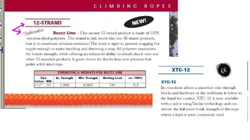

... One big issue for most is if it is splicable. 12 strand lines aren't and neither are most kernmantle lines...
not 100% true...
Spliceable 12 Strands Link
Just keepin' you on your toes! /forum/images/graemlins/grin.gif
Yes yes Nick, but most aren't and the ones that are can be a hassle. I had one spliced in Salt Lake City by Stanley, but it wasn't technically correct. Sure it was done well, but I doubt that the manufacturer would have said "go". And some 12 strands have a very large splice that will get stuck in crotches and such.
Fly is an exception to the kernmantle as well. I'm sure that you knew all this already Nick.
very true about the large splices..... i hate them.... i do quite a few crane removals and i like to tie in using a rescue pulley attached to the cable (when the operator and i deem the tree too dangerous to climb!!) if you are using a rope with a large bury area on the splice, sometimes it is hard to retrieve it before you make the cut(by too dangerous i mean that when the operator wants a big tip /forum/images/graemlins/applaudit.gif).
