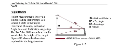

I just looked on eBay. There are a bunch for under 500. @Treeweasel do you have to shoot the base then the top of the tree to get height? If so how would you figure if a house was in the way because you're setting up in the front yard?

For me, having a knuckleboom, I only need to know the distance from my turret to the tie in point. That tells me what my capacity will be at that distance. As I get lower on the tree, the amount (length) of boom required generally decreases. In the event of a house being in the way, I can either utilize longer slings or more jib, and adjust the weight of my picks accordingly. I hope that helps.
On the TruPulse 200, I use slope distance mode (SD) to determine how much boom is needed. It works perfectly for me.

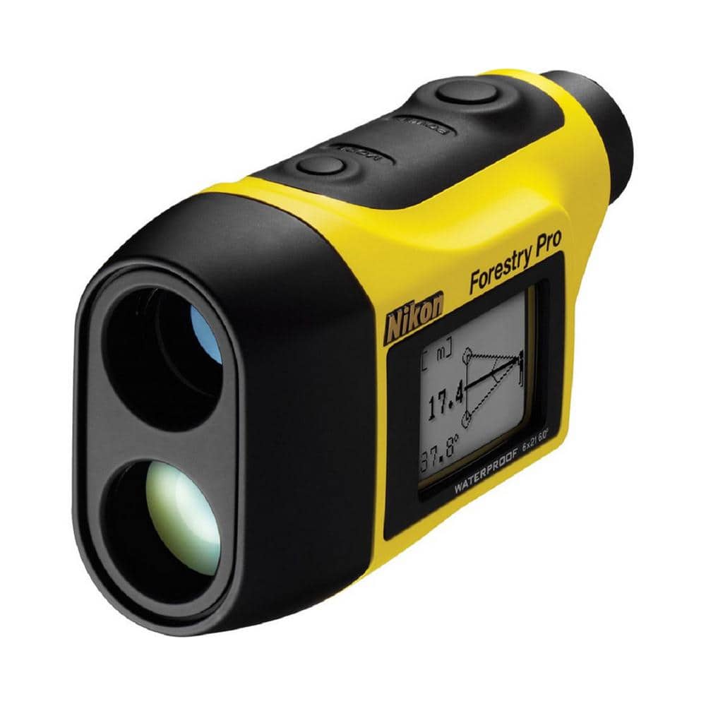

Nikon RifleHunter since 2011. Golf, hunting, shooting, tree work has been flawless. I have literally put a stake in the ground for a couple of customers marking where the tips will end up and nailed it each time. It is very accurate. I use it on 75% of jobs. Limitation is 10 yard minimum measurement for mine.
