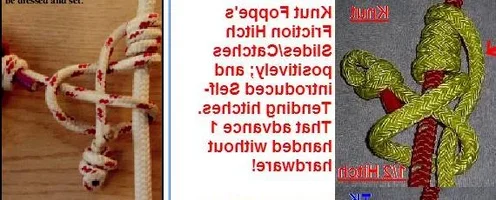

I believe he's aware of the discrepancy. I know I've told him directly in the past that the "Knut-converted-from-Distel" (your second [present] link) has never worked for me. I believe he'd said it did work for him, but that he was aware that it was not "properly" a Knut.
Glen
right so the first one is a genuine knut. the second one is the one ive tried and didnt like it, i'll have to try the proper one tomorrow
I've flopped the image from Ken's site and placed it next to the one from the PDF file. See attachment.
Glen

I'm tying mine like Mahk. I just sat here and tied the knut and it is quite a bit shorter than the Vt. I like it's compactness. Hoping to give it a try this week. I do like how it stays on the rope by itself as the biner is put in place. It also seems to advance fairly well without a slack tending device.
Glen those sure look like the same knot to me.
That was rather my unstated point.
Seems I recall Mahk (is he "Mark" from Boston? :) saying something about tying it left-handed in/for that article photo, or something. Obviously, you'd want to counter the direction of the twist in your rope when using 3-strand, but I don't see there being much of a difference between right- and left-hand versions otherwise.
Glen
