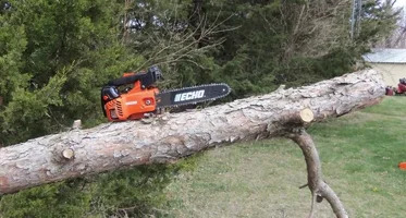

Today, I gave the Echo CS271T a good workout... tomorrow, the little Snellerized MS-150TC gets a turn.
It's going to have to be good... the little Echo was very impressive.

It is, and I do. It's very zippy, spins up fast and seems to hit higher RPM than the Echo. However, the 271 has a lot more grunt in the cut, really noticeable when you're in 6~8" wood.
Granted, though, neither saw was really intended for that... I used the 150 today until I hit wood over 3" then switched to the 201. I really like the balance and feel of the Stihl, and always have, so I think the 150 beats out the little 271 there, but the Echo has a little bigger motor and the bigger chain... so doesn't balk in bigger wood that the 150 is a little gimpier in. On the little stuff, the Stihl is much more nimble, quicker and the carving blade lets you get in tight places. On the pines, it was a joy to use when cleaning the spar.
A long day with each saw... still early days, but so far, I can positively say that I'm not getting rid of either of them. I think either of them would make most folks happy.
As many have said... get a few tanks of gas through them before you write them off... these little ones really get stronger as they break in. You can feel it doing it in a single day if you're making a lot of cuts (I was removing 3 dead pines today, and a lot of 1" to 4" diameter elm and ash saplings). Tomorrow, going to give the Echo PPT-280 some action. I don't actually need it for this job, but I want to run a tank or two of gas through it and see how long it takes before my arms fall off from holding it up...
