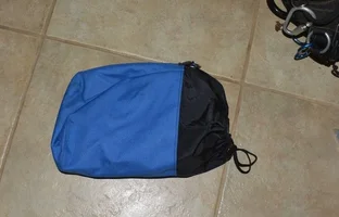

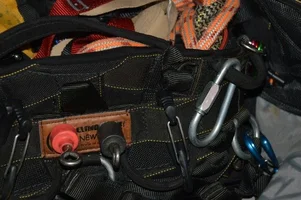

Small cube for in tree throw line management, dual chalk line, "little" shot sling shot, one of the new Buckingham Bismuth Throw Weights from treestuff.com I'm looking forward to using. Thanks Tree Stuff for TAKING THE LEAD OUT.

How much line do yall carry in your bag when using the weighted line in the tree?
I just wind Zing-it onto a fly reel until the reel is full. I believe it amounts to something in the neighborhood of 50'. Whatever length it is, it has always been sufficient.
I like that dual chalk line YOYO. I believe I've seen you use it on one of your vids. For traversing, you can cross a limb and one is being let out as the other is being reeled in. Seems pretty slick.
