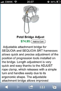

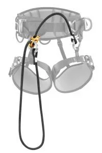

Petzl had a pretty sweet adjustable bridge they had on display at the itcc, attached to the open ring, basically looked like an atc device, they said it should be rolling out at the beginning of the year.
Thanks you for this information. The new bridge is already listed at some german shops and is was promissed for mid of January for about 65 Euro :foto:
[edited because I wasn't in sync with the calendary :loco:]

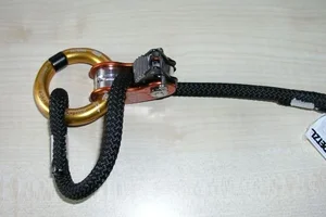

For all Sequoia owners which are able to organize a longer rope with sewn eyes (that was my issue)...the RollNLock also fits to the Ring Open and maybe there is no reason to wait for Petzl:
