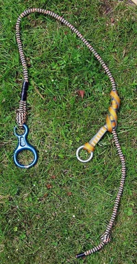

I have 3. This 1 is made from 3/8" tech12 (18,000# tensile). There is a 4' Buck R & R for length comparision.
Another is a 6" Buck ring & ring w/ a small ring spliced on 3/8" tenex.
The last is NE 1/2" X 20' braided Safety Blue. Large ring eye spliced on 1 end, with a small ring spliced on 3/8" tenex as a prusik. Made this 1 long before the 11mm ropes came out.

One way to make it more useful is to use an appropriate carabiner instead of the large ring. That way it speeds up the process of adjusting. You can just unclip, move and reclip.
It isn't as noticeable if all of your climbing lines are spliced. This way is much faster if they aren't.
Tim, I JUST switched my rope guide from having a large ring to having a carabiner. I had to do some toying around to see which carabiner would allow the pulley to fit through, but NOT let the adjuster slip through, but eventually found one in my stash that works perfectly.

I use about 10' poison ivy spliced onto the big ring. HRC with double fishermans on the small ring tied on with a prussic. Then a stopper knot at the end. Simple, easy and cheap.
