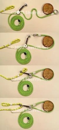

after finding a RG thru Sherrill and using it I can tell you that the device is well worth investing into. the set-up I had was just like the one shown in a pic previous in topic using petzl biners and petlzl fixie. the biggest difference is in retrieval. the fact that the ART device, its not a LJ, loosens as the line pulls thru makes a big difference. the whole system falls out of the tree faster that pulling your line out. here is the next problem, the pulley is exposed making able to be damaged when it hits the ground. whereas in the fixie the pulley is covered. the ART device is very sturdy and seems to take impact on earth well but would hate to see it hit concrete so controll lowering this device is a must. just an added thing to carry in the tree. my pulley on the RG is already showing signs of wear after only 1 day of not control lowering . I called to get replacement but do not know if it is a part that can be purchased. the original RG's I saw had brass pulleys or seemed to be brass but mine is plastic and was wondering if that was because damage to the pulley is inevitable and a brass pulley with a burr in it would a bad problem. overall I think the $178 investment is well worth it compared to the aprrx. $80 in biners,pulleys, prussiks, shackles and the sometimes headache when your system doesn't come out of the tree. though there will always be trade offs, it our decision as the climber to decide what trade offs you want..............oh yeah ,Sherrill should let people know in their instructions on how to control lower the RG especially if there is no replacement parts.
Here is a picture of the RG series. Sorry about the copyright overlay, but I can't risk somebody "borrowing" our images.
I hate it when that happens.
To hear that it takes impact on earth well makes me cringe alittle. You did say $178, right. Brian, I hear ya man,the logics in that price range doesnt seem right. Someone had a pic posted that looked really good, cant remember who, I would probably make 1 or 2 of them up for Pines maybe or some other real abusive job or whatever. Certain jobs, maybe break out the bling-bling piece. It does look good, cant take that away from it. Maybe a show and tell thing at a comp.
It's a newer design. I think Beddes showed the one he did first, with the little shackle that had a pin you pulled to release a biner, at ITCC in Eangland. Maybe following year??
The RG now has worked it's way there ya know. You have a good argument Brian, no doubt. I saw a guy at TCI use it for lanyard too. Plus it's a writeoff. AHhhh, have fun with it.
Later
As I don't tire of mentioning, these products are developed in close cooperation with climbers by climbers, insofar there is definitively no intention of ripping anybody off- neither in initial purchase cost, nor in availability of replacement parts later on. All individual parts are replacable... talk to Greg Good and/ or Sherrill about it!
As to dropping the R.G. from a hight... in terms of materials used we're talking very high tolerances: the body is made of constructal aluminium (that's what Porsche uses to make their disc brakes of), which is a very high grade aluminium- toughissimo! The shackel is drop forged, meaning you can bend it by 180° without it breaking (not that it'd be a good idea!). The pin that holds the pulley in place is self-securing and lock-tightened. The weak point that might get dammaged is the cam- if this got gouged it might not fit into the body cleanly anymore and not cinch up against the rope.. in this case the worst that can happen, is that the rope'll run through to the stopper knot.
The reason the brass pulleys were replaced was that we found they were getting damaged to easily. This plastic pulley has proved tougher and alltogether more suitable for this application.
Dropping false-crotches from a hight onto hard surfaces is a problem! How many people do you know, that use a throw-line to de-install with? Not many, I bet! Think of false-crotches useing carabiners, instead of rings. Not only are these biners weakened by the wear of the rope and manufactured of a lower grade of aluminium- they're definitively not meant to be dropped in this fashion.The R.G., to a degree, is. I'd be most worried of someone getting injured by the thing falling on them!
One suggestion for de-installing is to take a throw-bag up with you, install the R.G., toss the bag out of the tree, feed it through, choose a fork above the R.G., have the throw-line pass over this & fix it with a small carabiner to the eye of the ring on the R.G.. To de-install, just pull the line out normally holding the other end of the throw-line.
