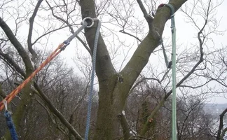

The best way to use it is to attach it to the leader without help of a branch underneath it to support it. And there is no need to wrap it several times around the stem to keep it in place.
Just the pulley thru the ring and do your thing.

Treespotter, I've been using my prussic based RG identical in layout as yours, differences being, the host line is Blue Streak and the prussic is 5/16 Warpspeed (samson)girthed to the large ring. Problem I have is on 2-3" dia. TIPs I get the pulley stuck on the ring 50% of the time. Any suggestions/observations?
this might be a dumb question, but with a setup like in treespotter's picture, how would you retrieve that from the ground?
You retrieve a FS like this by connecting a little 'harp' (a little connecting divice that is one milimeter wider than the clinbing rope) to the climbing rope (the side that goes from the pulley to the friction hitch).
So, if you unclip from your saddle, the end of the rope goes up into the tree, thru the pulley, gets stuck in the 'harp', the harp puls on the end of the FS, the pulley is pulled out of the ring and the whole kit tumbles down.
If you are happy with the kit you use and if your life means something to you, than you put a throwline on the end of the climbingline before the rope is pulled out of the tree.
