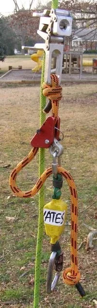

Here's an early version of the tether. Way too complicated.
Since the ABR is a 2:1 adjuster it's easy to take slack by just popping your hips a little. The ring redi makes the adjustment a pull down instead of pull away/up.
My Uni is now mounted directly to my adjustable bridge which is a simpler system.
Save me some typing...what do you want to know about the ABR tether?

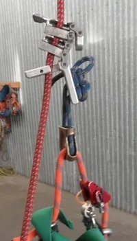

You can see the microcender on the right side of my bridge. It's used to adjust the length of the bridge. I can shorten the bridge bringing the Uni tight and it is in the same position as a lower/chest ascender for using a frog/tree wallker setup. Sometimes I use a shoulder tether but not always. It seems to tend itself nicely.
If I want to use the Uni for the upper during ascent, using a Pantin on my right foot, I slide the bridge out. The length of the bridge is made so that when I hang in a 'neutral' position I can reach up and activate the Uni for descent. Too often I see climbers with tethers to their upper ascender, or ascending loops in the case of DdRT. If they ever need to get a hand up to release the upper they will have to do a footlock to move up...not a safe setup.
When I get to working position I adjust the bridge out to keep it above or below my face. I've had real nightmares about gear smacking my mouth and spitting teeth...they are so real that I wake up!
It takes very little unweighting to let the microscender open and lengthen. Same for shortening. Just a little hip thrust and I can move it out or in.
On my TreeFlex I can slip the tail of the bridge through the aluminum ring. This keeps the tail fair and is easier to adjust. I think some other saddles could be rigged this way too.

What If I just quicklink the uni to the swivel on my bridge?
I can use an over the sholder to keep it up during ascent and it will be close for when I am working yes?
Tom really nice idea with the adjustable bridge. I got one of the early uni's as well. I find that the slack doesn't fall through as well as I thought it would. Any suggestions?
223...depending on which way you want the clutches of the Uni to face. You can slide your bridge through the slot in the lowest el too.

The ABR is the unit that Rich and I worked out ....
http://www.treestuff.com/store/catalog.asp?item=1697
