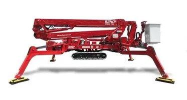

It works.... so far. That picture was taken on day one. Have a bit of tie down work to do and see if the DW will fit on the back but it rides nice and it’s not banging the trees going down the road at 10’5”

Yeah. We rented one of these lifts a few times locally before we decided to buy. They hauled it around on one of these. So we bought the lift in December and a trailer to get us going for a few months until we could find something like this. Works pretty good. We just need to work through tying down options as the chains and binders we had for the trailer aren’t ideal.

I really like our truck setup
I believe it’s the best way to load and unload using the outriggers
Easiest on the under carriage, boom, takes the chances of sliding on a ramp especially parking on in level ground Also keeps the lift out of the elements especially in the winter
Does anyone use this technique for loading on a trailer?
I would think it’s even easier than my truck setup because of my truck deck is very narrow to get the lift centered and a trailer it can be off a little bit more
