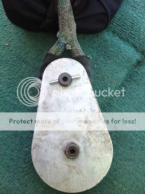

once again I am looking for one of these blocks:
Or this one
Either one in a lightly used condition
Re: 1\" Hobbs rigging block
Yep thats what i'm looking for norm. How much?
Sorry, it's a piece of history. I can't part with it. It's the only one I've ever seen.

What were the chances of that Jeff. Ian sure hooked you up. Nice one, this is why I like the buzz. One helping another, very cool. A new one to boot too. Hope things work out on your next big fella, no broken slings now.
Right on, glad that worked out for you. Cheaper than a new cmi block, too! Glad to help, that's some big azz rigging to be playing with. Much respect, Alohas!
Next time anyone sees a 1" Hobbs block on Ebay, there's a good chance it's the one ripped off from me in October, 2015 (bought from Don Blair about 10 years ago). I'm thinking of replacing it with the DMM 6.7 ton WLL block. They call it an "impact block", so is it possible there is something in the engineering that makes it legit to rate it at 1/5 for wll instead of 1/10?
