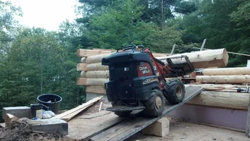

I bought my first DW Zahn r300 Nov 2020 and I put a grapple on it and I love it! I was skeptical too at first. At the end of the day all those logs you would have loaded by hand you are now letting hydraulics take care of it. Yes I have a bigger Kubota to move the big wood. Lets face it we are all getting older and we are not going to be able to do the heavy lifting forever. And who wants a bad back from manhandling those biscuits out of a back yard when you can have a compact load do it for you. My Zahn goes out everyday. When it goes in for service we miss it big time. You wont be able to pick up the whole tree but you can take it little by little. At the end of the day your back will thank you!
PS we are looking to pick up a second one soon! follow my youtube channel socalarborist I'm posting more vides for my DW Zahn in action.
