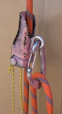

On my RADS I use a Shunt with a tether to make it self-tending. The shoelace tether can be adjusted to any length that is convenient. For ascent I like it a bit longer. For working I shorten it a few inches to keep it even more in-reach.

I think I get your set-up, the shunt comes down with you as you descend? (with the self tending tether?) I need to understand this. . . What about going up? I can't picture it without a hand ascender up there to grab onto and advance. Do you use a pantin to ascend?

There is a way to palm the Shunt and push it up the rope similar to a handled ascender. Of course...keep gloves, hair and loose flaps of skin away from pinch points. I've already done the mental engineering on a handle that would bolt onto the Shunt using the through bolt at the bottom. Since the Shunt isn't part of life support I wouldn't have any problem with modifying the design.
A Pantin could be use but it really doesn't work well with RADS I've found. To keep the picture clear I didn't put in the adjustable foot strap that clips in.
Since I use a Unicender I really don't spend much time on RADS unless I take a new climber up.
The same setup could be made using a friction hitch with a slack tender on top of the friction hitch. When the climber descends the slack tender pulls the FH down.
