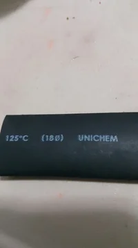

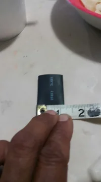

Ok so it is 1 3/16" laid flat. I slip it on and use a reg lighter to shrink it....works mint. 3cm laid flat. Slides right on and is faily snug. Then heat tightens it right up. 2019-08-10 21.52.14.webp2019-08-10 21.50.10.webp
