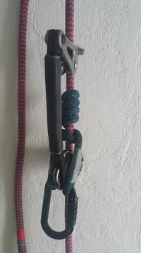

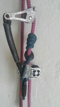

It is my second red one. Was pretty beat up so sanded all the color off....like that Black HC. Love the fucking thing. I have 3 of them though. 6 HCs ...soon to be 4 and 7....lol
Swing did you put some more black shrink wrap on that tether? If so what size shrink did you use? I would like to stiffen up my ISC shorty and was thinking some shrink wrap might do the job nicely..
Yes indeed Erik. It is way too bendy as stock. Will check when I get home. I have a bit left. I have been doing it with all tethers. I hate all the stupid advertising as well. I am an all black no labels kind of gut. No frills.
