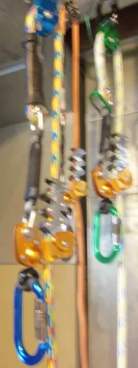

Ok... sorry for the blurry pic... this cheapass camera only takes acceptable pics in sunlight with the flash off. Basement is too dark even with lights to get decent pics. The results were along the lines of what I expected, but also very different.
Left measurement (in millimeters) is rope measured just above the ZigZag with about 20 lbs. of tension. Right measurement is with about 50 lbs. of tension. Not enough height down there to hang in the saddle, so I might repeat this all with more ropes and more devices in the coming days. Peak of garage roof is about 22' up, so will get a hook or screweye put up in there.
Aztec 11.7mm -- 11.77 / 11.16
Voyager 11.8mm -- 12.26 / 11.94
DrenaLine 11.8mm -- 11.82 / 11.56
Well... the Voyager really is bigger, as I thought. The other two are really right on the money for the advertised diameter at 20 lbs. tension.
The Voyager and Aztec also were about tied for flattening out at 50 lbs. and the Drenaline walked away with firmness at that weight. Barely flattened at all. Tightest cover by far. The other two were very similar... I think I'm going to give the Aztec the edge, there. The Voyager is a little baggier, I think. It's also bigger and has a nylon core. We'll have to see what happens when I load them up with 200 lbs. of pure, lean muscled climber. Assuming I can find someone that fits that description.
