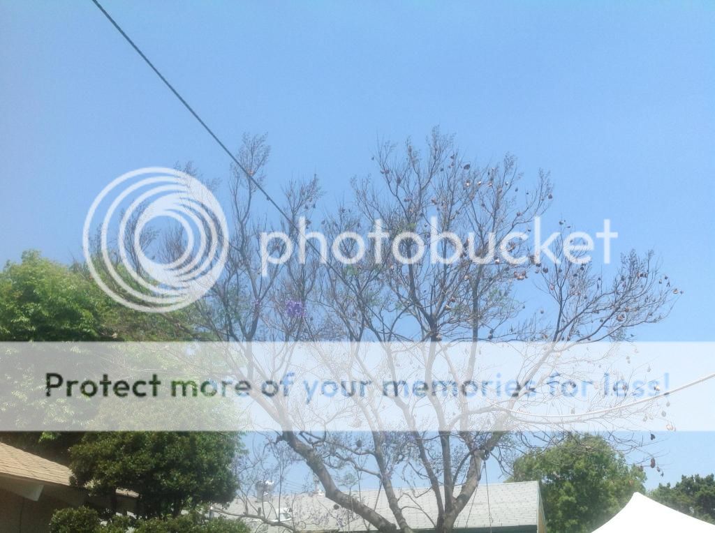

Deciduous Jacaranda branches or not they aren't coming back to life. They're dead, and they snap off like they are dead.
I don't doubt some of the lower branches are dead on the jacs, very common. However I'd be totally shocked if the whole tree's dead without a herbicide being involved. The very jacs you think are dead will most likely be blooming a profuse purple a month or so from now.

The jacs have stored all their energy for their blossoms which will bust loose any time now BB.
This is a jac pic taken today, and to an amateur it might appear to be dead or dying. But believe me, a few weeks from now it'll be a pure purple cloud.
