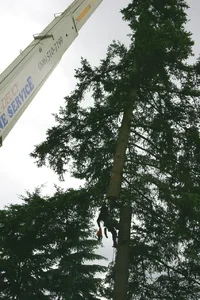

A couple things though....the way I prefer to cut is one cut straight through....starting directly below where the slings are attached. Normally the cut will open up automatically. Makes for a clean end, and is a piece of cake 98% of the time.
Also, what size was the crane? Those picks look mighty small, for as close as you were.
We just finished a 5 tree fir log job...about 2200 bf, and 9 picks, four of them included the branches..so about 35,000 lb., with the 23 tonner.
