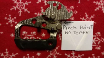

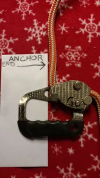

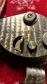

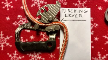

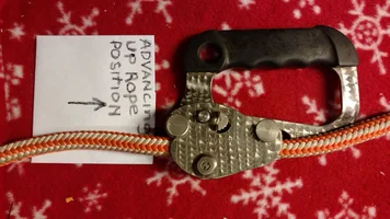

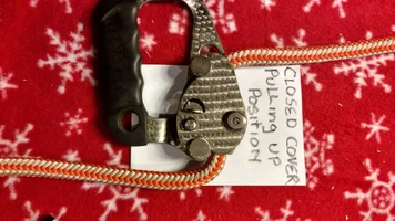

This is the old ushba hand ascender I spoke of earlier. Pinching lever no teeth. Made of titanium.

Thanks...sounds like a good project
Who is teaching you about rope installation? There are several thowline shooters available. More important is understanding how to qualify a TIP..tie in point. Since this is for rescue you're likely going to have to consider a two person load on the TIP..plus amplified shockloads.
What books do you have?
