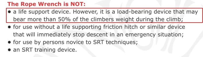

I like the idea to use the CMI RP140 Pulley as a Rope Wrench. BUT has someone measured the load decrease compared to the Rope Wrench? Because of the length of the main leverage I doubt that the pulley is as good as the RW.
I like the idea to use the CMI RP140 Pulley as a Rope Wrench. BUT has someone measured the load decrease compared to the Rope Wrench? Because of the length of the main leverage I doubt that the pulley is as good as the WR.
Its not, but works quite well
Also with friction hitches or only with mechanical devices?
Seems I have to refine my question that you know what I mean and it is not seen as "stupid"
My experience is that mechanical devices are more insensitive for higher load than a friction hitch and you can feel on a hitch if the load exeeds the normal. Not so on a mechanical device.
And for the RW there are all important infos available:
- ISC UM: "may bear more than 50% of the climbers weight"
- load reduction has been confirmed by Richard M and Patrick B recently
- "prooven by use" (a high number of RWs are out there)
- RW has CE approvement (minor issue even for me)
I still like the idea with the ICS but "works quite well" is not sufficient for me.
