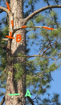

The tree is an otherwise healthy pine about ninety feet tall and over three feet in diameter at its base. The limb is about thirty-five feet up, and is almost parallel to the trunk.
The two cuts just below A were made long ago by someone else.
I want to get rid of the dead wood marked in red above B. I was climbing on the far side of the tree the other day to cut a small dead branch higher up. I reached around to see if I could do anything, but the live part of the limb just below B felt like it moved around much more than it should for its size and length. I didn't feel comfortable tying off to it while making the cut with my 10" folding pruning saw.
I've got a new TIP on this side of the tree now, but I'm not sure what to do. The limb at B is about three inches in diameter. With the limb moving around, it's probably going to be harder than making a slightly larger cut at A. I don't usually like to cut off live limbs, but this one just seems wrong.
Should I cut it at B to get rid of just the dead wood, or cut it at A to get rid of the whole weird limb?
Wow, I'm embarrassed that I completely missed seeing the canker. That probably explains the weakness I observed. Now I'm excited to get up there and check it out.
If it was my yard and nothing at risk, I might leave it or maybe yank it out with a throw line. Unless I was looking for excuses to climb something ;)
"A" is not a branch-collar pruning cut. Its above a whole of pruned branches. If going for "A", you need to make a limb-removal cut at "A", and finish at the branch-collar with a final pruning cut of the stub.

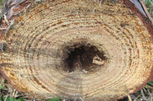

I got a closer look at the limb this afternoon. The limb was in bad shape with cankers on all the live branches, so I made cuts from the front and back that almost met just above A, attached a rope, came down, and pulled the limb down from a safe distance. I didn't want to take a chance with the limb falling on my climbing gear around the base of the tree.
When I cut the limb up, I found the center was hollowed out by rot far below the big canker.
I'll go back up to make the final pruning cut.
That's not the most straightforward branch-collar to find.
Remember that you are trying to take all all the branch that you can (some is inside the trunk) WITHOUT damaging any trunk tissue. Better a tiny stub that damage to the trunk, if in doubt.
As it turns out, I had to make the final cut just above where the two small limbs had been previously removed. There was a slight dimple in the trunk, and I would have cut into the trunk itself in order to make the final cut any lower. I made the cut perpendicular to the trunk, and the wood looked pretty healthy all the way across the cut. It looks good from the ground, too.
