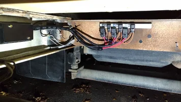

What is it and why should every truck have one?
Has to do with shitty wiring on a trailer not blowing fuses or something on your truck?
Bingo.

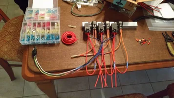

It isolates the truck from the trailer. The trailer will get its power from the dedicated circuit. The individual fuses isolate a fault to an individual switch leg. I have 15 amp fuses in each now.
If the trailer is shorting while driving you will at least have half of the lights and all the truck lights.
One relay is for the running lights, one is for stop/left turn and the other is for stop/right turn. The space is for reverse lights or something else.
This could incorporate a converter relay to convert between 6 way heavy duty DOT and 7 way RV wiring. It could also combine separate stop and turn signals. I just needed the three relays.
