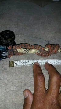

Sitting around playing with my gear today, I took the 15 year old cmi micro pulley and knoted hitchcord off of my lanyard and put on a new stitched rit eye to eye with a micho and a pinto. Damn is that smooth! I see why some of you are willing to spend the extra money on stitched eyes and pinto's. It kicks ass clipped back to the becket in ddrt formation too.
I used a VT on lanyard for a minute, but was longer than I wanted, distel seems much more compact and still responsive (def not as responsive tho). I'm sure you have tried all hitches on the hip, care to elaborate on your choice?

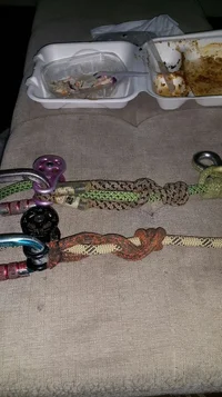

I use a longer prussic and a micho on one of my lanyards. A beeline. But I have 4 others setup like this. The very short 18" prussic makes a very comact reliable 2/2 VT for my fav 10.5 lines. 2019-09-14 20.19.48.webp

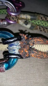

That bottom one is molded and shaped for 10.5 platinum. It grabs and releases flawless I tell you. It is a hybrid made in 2013. Poly 8mm AP cover with the core of HRC spliced with locking brummels. Naked eyes to fit neatly in the pinto no pinching. The little things....perfection. I have a couple more and a couple full HRCs.....
