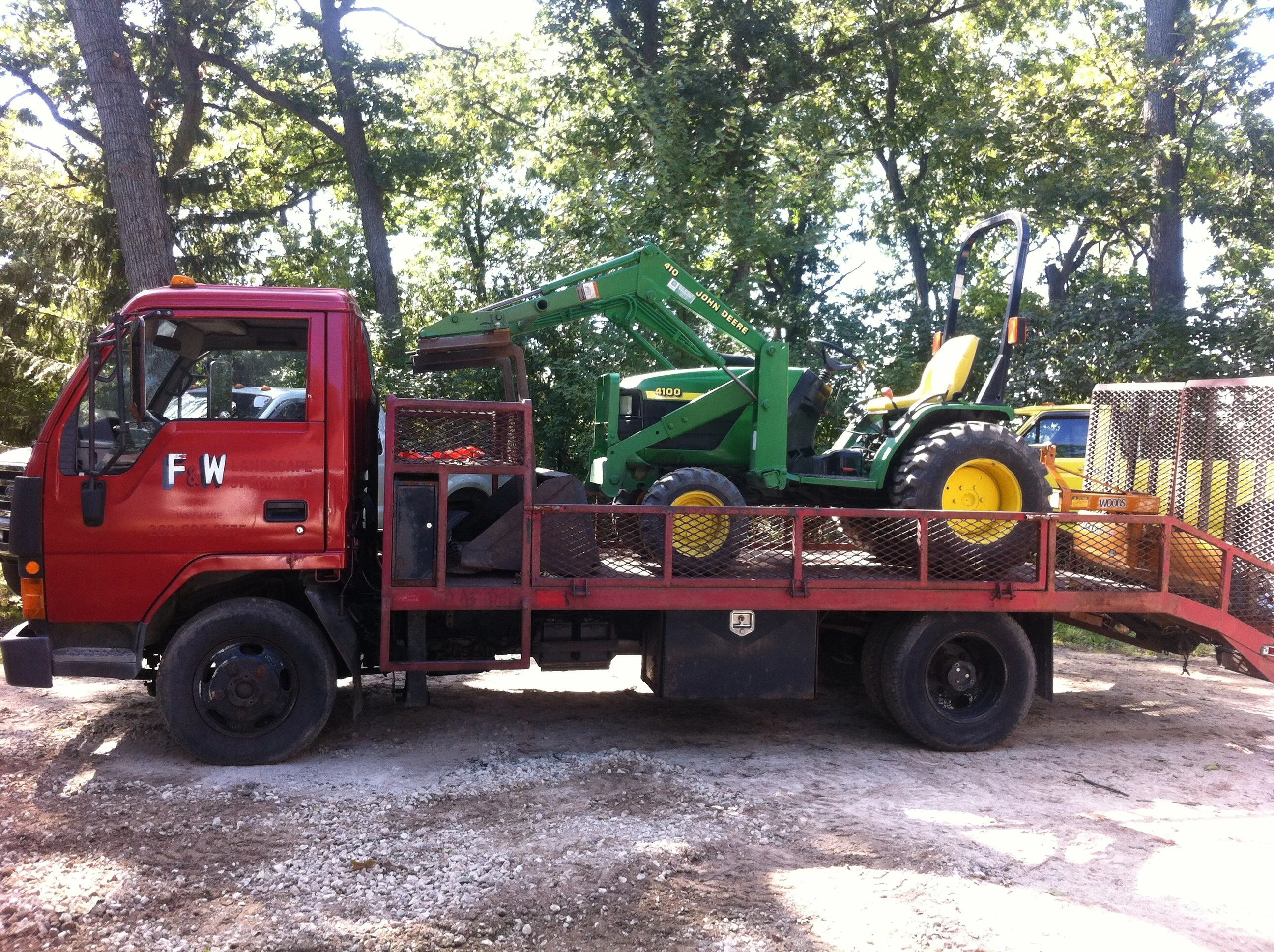

I think you have too little of a truck for also adding a platform for the mini. If that is your intention. I might be wrong. Can yoou post a picture of your truck?

I will get some pics up soon. As well as some feedback on the setup. It will see its first job tomorrow morning!

The frr's still have the lower frame but have the 7.8l duramax in them allowing for better towing. I have a 12' switchngo, dingo 420 and the 1890hd and it pulls loaded just fine. Cabovers are the only trucks I will buy for these residential areas. It would be different if I was out in western open roads though.
