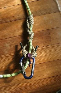

I use three wraps and three braids of Ice on Tachyon. I am going to start mixing in 1/2" Safety Blue for some climbs, which has the same coating as Tachyon (I think), so I'm hoping for the same results.
You could also try the XT (pic attached) for another option.
-Tom

I use the the same wrap/braid configuration in Tom's picture from the top down until you get to the second braid. I put a full twist on it, pull the legs on the other side of the rope and hook up (no third braid). 8mm Ocean on Velocity and PI.
Normally I like less wraps and one more braid but I'm using a longer hitch cord than usual.
I had this one HRC cord that was PERFECT when it was tied 3 over 2.
Not a great pic of the whole hitch but...
I use my eight to take my weight(180) off the hitch when descending. It'll make the bee line last a lot longer.
