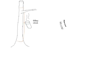

If the SL is anchored at the base of the tree, isn't the chunk likely to crash against it (or the VSL section) and damage the rope? Limbs don't sound so bad, but a 12 to 18" diameter and 1-2 foot long section of wood could do some serious rope cutting.
Am I envisioning something wrong? See my rough drawing.
(Glens, this png is for you) Thanks.

Tom, I reread your post...maybe a longer choker for the chunk will take care of my worries. The anchor tied too high would cause the biner to jerk the anchor wrap of the VSL...but with a long enough choker, that would not happen.
Seems like it would also help contain chunks to a small area...perhaps where a landing pad of some sort (foam pads per Ekka) might be set up.
