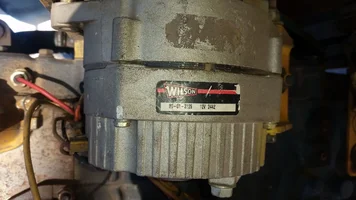

Would also like to hear if anyone has found a new alternator from a parts store that works with their bc1250 as Vermeer wants $250 just for the alternator as I believe it to be the reason my autofeed is not working because my tach does not like to work not to mention brand new battery holding charge.

We've ran a 1250 for a while now. First of all we've found alternators for our 1230 and 1250 at our O'Reilly auto parts store. As far as the rollers go, have you tried adjusting the small rollers on the top of the feed wheels? We've had issues with ours being out of adjustment and the feed wheel tilting and jamming up. Also make sure they are well lubed (I put some grease in the track for the feed wheel also).
Thanks for the reply N.E.Tree. do you you by chance have a part number for one of the 1250 perkins alternators at oriley? Ive tried cross referencing out of the parts manual with no luck. I can only find ford gas alt's on ebay. I like your thinking with the rollers for the wheel, I will have to investigate more into that. I have grease them really good as you have mentioned. Do you by chance know what hydraulic fluid your guys put in them? Thank you

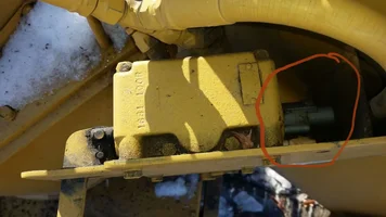

I'll be back at work Tuesday, I'll try to get all of that info then. We've also ran across two other issues that have affected the hydraulic rollers. One problem was a tensioning rod on the hydraulic pump. It holds the pump over, putting tension in the belt. It broke and slacked the belt giving very weak in-feed pressure. The other problem was with the valve that the curbside lever is attached to. On the back off the valve (opposite the curbside lever) there is a small (somewhat cylindrical shaped) metal piece bolted on. Our bolts vibrated out and let the piece free of the valve, causing the in-feed to function incorrectly. I'll try to get pics of these issues I'm describing

OK buddy, hope this helps. Here's the alternator. Let me know if you need more info off of it20151202_101221.webp
Here's a pic of the piece that came unbolted from the valve causing low pressure. ( pic is from top down) this is the valve with the curbside lever. 2015-12-02 16.37.04.webp

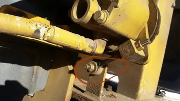

Here's a pic of the tensioner bolt on the bottom of the hydraulic pump that broke (causing low pressure on the in-feed)2015-12-02 16.37.51.webp
Excellent, Thank you for the info. I will have to take a peek tomorrow at mine to see if either of those low pressure issues are a culprit on mine as well. As far as the alternator the last few days it has been working fine but must have something going on to cause my phantom problems with it. I tried searching for the rubber meets the road with no luck? Thank you!
