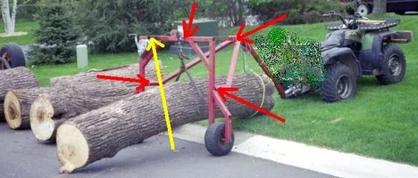

A buddy of mine gave me a homemade arch. In the picture you'll see the yellow arrow pointing to a male 2" reciever hitch. The red arrows are the places where the unit would come apart for transport. The arch would slip into the receiver with the tires up in the air. That unit would haul some mondo loads. The winch was used to lift the logs. Most of the time I'd use skidding tongs but sometimes just a sling to lift loads.

any chance of getting some closeups of the parts of your rig? BTW, the pic has a scrambled section near the atv...on purpose to hide something top-secret? Do tell! /forum/images/graemlins/grin.gif
The arch went to the scrap yard when I moved from MN. Nothing fancy that a good weldor can't make up. The unit had round stock going into the square tubing to knockdown. If I made one I would use the smaller reciever hitch materials. Northern sells them cheap.

Your eyes are too good :)
