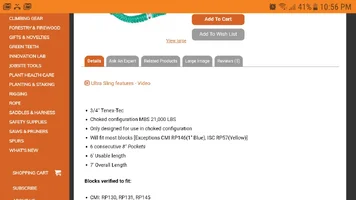

Usable length 6' ?! So you can wrap it around a 1.9 ' diameter tree, max? Seems a little short for a 3/4 inch tenex "block" version. Screenshot_20190319-225622.webp
It is a little short at times, but quite convenient. For larger diameter trees, if using a pocket sling, I use the one treestuff sells for the portawrap. Same size tenex, and much longer.
I'm just giving tree stuff a hard time. Plenty of times that's all you need.
