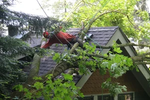

We had a rare thunderstorm with north winds blow through a few weeks back.
The first video is of a a failed double cottonwood. Required setting GRCS and Hobbs, each in different trees, in order to lift the tree off, then swing it clear of the house. With these great tools, the job was a breeze. Could we have done it with no damage to the house without them? Yes, but it would have not been a cakewalk then.
http://youtu.be/BStwd6rfI6M
The second involved another company that Pat also works for. He told me about it, having not seen the tree. I offered to come, supply the GRCS, Hobbs, and static line, and run cameras, and direct the operation as needed. It was very similar in that we needed two lifting points, one to support the tree, and the second to swing it clear. As you will see, the Hobbs is an inefficient lifting device, as compared to the GRCS anyhow. In hindsight, we should have switched their locations, as we had much less tensioning and lifting to do where we had the GRCS installed. It was a fun job to shoot with both vid and stills
Unfortunately, for now anyhow, you'll have to watch it on my facebook page.
http://www.facebook.com/roger.barnett.96
The second vid is the first one that comes up on facebook, and it is too large for vimeo or youtube. And, I'd have to start over with the editing of the individual files, ( a 2-3 hour job) in order to split it into two for youtube or make it shorter...Dang it.

The one handing bandit strikes again!
Good work Rog!
Did the gang shake the posse and make it back to the hideout ok?
I hear you and Sir Reginald are planning a heist together?

Nice work Roger. I love those jobs.
On the 1st vid, what happened with the peeling bark towards the end of the vid?
Looks like one of the blocks slid a bit, eh?
Some of those cuts in the beginning of the first video looked a little dicey to me, but maybe they weren't as risky as they appeared to be. No matter really, you got em down and everybody goes home happy.
No dice (read not dicey) at all, Sir!! The larger trunk was shielding me and the ladder from the second smaller trunk that I was cutting.
If I'd have been worried about how the trunk I was cutting would react, I could have used a saw on a stick--if it had been on the truck instead of at home. But it shared the same root wad, So I knew there would be little movement.
And, I think the first stump cut and the next ones went quite well, and as expected.
Norm, 'twas a young water laden cottonwood. I didn't notice it till the tree was ground bound. I imagine the sling slipped down during one of the times we cut off butt sections, which woulda caused some minor shock loading.
That's what I thought. I've had that happen on Eastern cottonwood (Populus Deltoides) here in NE Illinois.
(approx. 15" at the anchor point)
Pretty cool jobs Roger
I always like running around a roof while tied into a tree, not sure why. I find those job much more interesting probably because they are few and far between.
Did you guys think of putting 2 climbers on the roof to help with the cutting, chucking etc.?
Good work on both jobs!
Way to get er done/down
Heartt racin stuff.
Thanks for sharin
BzRman, Pat handled the roof work really well. It helps to be young and super strong, as he is. And, the tree really wasn't that large. He only had to lift off 3, or 4 at most turns of limbs....and he cut and chucked all the wood--with that fine tuned one handed skill that old cowboys like me love to do.....
Great vids. Rog I did like the detail in the detail in the slinging of the trees off the roof. I have worked double trunks before,and don't know why I never thought of doubling them up. Nice job to all involved.
