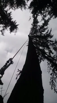

Trying out remotely releasable rigging techniques
Double-whip tackle?
I'd ditch that biner you're using in your tie-off. Why bother. Just take a wrap and tie it off with a quick release or even without a quick-release, use something releasable under load.
Nice work.
It looked like double whip to me as well. A slight variation that I used the other day was to use natural crotches on the pieces being rigged. This adds a little more friction to assist in controlling pieces and you don't have to make sure you have enough slings to finish the job. That job was a hackberry, so it was pretty smooth bark, that may not have been a good option here.
Another variation I like to use is setting up a rig-saver like an mrt friction saver, once it's on the ground the sling is retrievable for the next piece.
Double-whip tackle?
Yep, I tend to over do it on security when I'm over targets. I didn't know the definition of double-whip tackle, looks like I found it. Thx!
-AJ
I probably absorbed the double-whip technique unconsciously looking at buzzer vids over the years. It came to me as I was trying to create a simple remote rigging line release. I love when ideas lay dormant then show up at the right time. Need to hang out in the Rigging forum more often!
-AJ

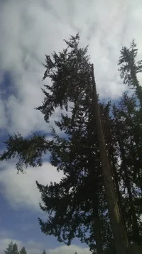

I rigged out this back lead in two speed line rounds, solo- lowering two low branches.
5' dbh fir.
Unfortunately, this meant that all the branches laid out the same way, ready for the mini/ bmg to pick them up. Made me look like I didn't really need a groundie that can't listen to simple instruction because "I thought you meant..." (plague of my working life).
...oh, wait a minute...
Working solo is sooo chill, but the mini doesn't drive or rake.
The low limb is about 10" at the butt. Self-rigged on a short piece of 1/2" true blue. Mostly made the wood fiber hold the limb to the trunk until it was vertical, then I lowered it 10', and it was oriented to drop cleanly, so I untied the rope, rather than hang it and piece it apart on the rope.
