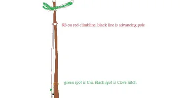

I have thought about a similar system for climbing trees/ smooth trunk palms.
As you said, using a Rig/GG/ Uni with long enough climbline would allow an emergency escape from any point. The Uni and Pantin would make a very efficient combo. Stand on Pantin, Uni advances. Sit on Uni, advance Pantin.
A pantin and hitch/ ascender with backup prussic or could be used for fast, leg-powered ascent.
Let's say a person had to climb some closed canopy conifer trees that had little taper and little in the way of branches (as I had to do on a cat rescue recently), or a tree which had being canopy raised, which seems like what you had.
If one were to attach the climbline with running bowline, and had a branch or pole (say from a bigshot or pole pruner) attached to the loop of the running bowline, then one could advance it much further for each "pitch". With a telescoping pole each pitch might be 15-18'. The pole would then hang on the loop ready for advancing once you reach the end of the pitch.
When you reach the top of the pitch, you could have a second running bowline'd rope with a 'biner attached via clove hitch (use a backup or stopper knot if desired to secure CH) to your bridge for a comfortable sitting position, then loosen the climbline's RB, and use the pole to advance to the extent of your reach.
I think that this would reduce the need for gear and switching back and forth. No systems would change, and the climbline would always be backing up the resting CH TIP. A Uni would be best as there would always be an emergency exit line. One could advance the rope past branches/ crotches in the standard ways.

Yeah, there's lots of variations that could customize it advantageously. The main reason I used a helical is to look at the least hardware intense or most minimal (most minimal
I have tried the pole thing and I have mixed feelings about it. Certainly a good idea, but it is extra gear and doesn't always work as expected. For example the pole can only lift one side of the cinch loop and the other side sags and snags sometimes. It's hard to get the entire loop around the tree like it should be and then load it before it slips. I guess one would have to evaluate the advantage vs the trouble and use whatever wins out.
Yep, the Uni and Pantin would make a good combination. I'm not sure I'm fully up to speed with you, but when one starts to advance the cinch, his weight needs to be fully on that second cinch I used, or something.
In addition, I needed a footloop on that second rope to stand in to advance the other cinch. But, one can simply sit on the second rope, release the Pantin, or feed rope through it and the Uni, and advance the cinch with the pole, unless there were small limbs that would have to be dealt with.
That first comment made me laugh.
I think that the pole idea would have some hiccups. My idea is that a person would have to do more than lift the pole to advance it, more like lift and work it side to side some. No testing on this end, only armchair imagining.
I'm wanting to make a few videos for a friend and when I find the time, I'll try my idea, and video it if it is successful.
I know nothing about video editing, so it won't be as cool as yours by any stretch of the imagination.
The footloop seems optional, with the full climber's weight on the bridge, maybe with a leg-scissors around the tree for stability.
The small branches would certainly be a hassle that would have to be dealt with either way. I was thinking that long advance idea would be good on trees that have been climbed before for pruning, moreso than rec climbing, or unpruned trees.

...I think that the pole idea would have some hiccups. My idea is that a person would have to do more than lift the pole to advance it, more like lift and work it side to side some. No testing on this end, only armchair imagining....
Ain't nothin wrong at all with armchair imagining. I bet a lot of good stuff comes from that activity!
...I'm wanting to make a few videos for a friend and when I find the time, I'll try my idea, and video it if it is successful.
Don't sell yourself short; go look at some of my early videos - I had to do a LOT of learning and I'm still learning.
...The footloop seems optional, with the full climber's weight on the bridge, maybe with a leg-scissors around the tree for stability...
I'm not quite following you on the footloop being optional, but I just may not understand it. Oh wait, I think I see what you're saying. I'm thinking like I did it in the video, i.e. put the foot ascender on the secondary rope and move it up as high as possible so when I stand, I stand higher and hence get more reach. But if I read you correctly, you're thinking just transfer weight to the secondary rope/lanyard/whatever and advance the primary with a pole or whatever. And yes you can do that. The way I did it, without the pole, I needed to maximize my arm/body reach because I didn't use a pole so I needed the footloop on the secondary rope to maximize reach.
...The small branches would certainly be a hassle that would have to be dealt with either way. I was thinking that long advance idea would be good on trees that have been climbed before for pruning, moreso than rec climbing, or unpruned trees.
That long advance is an excellent idea! I had to do a 40' climb like this in a pine tree that had no limbs until about the 60' point and they were questionable and I was chicken about it anyway. But I used two very lightweight telescoping poles to set the cinch as high as possible and it does help. I didn't have little limbs to deal with so that helped too.
