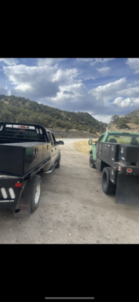

We just recently moved one crew from a chip truck to a 1 ton with the toolbox/bedslide setup. It's the best for us. We mostly do fine pruning and work with a dump trailer or chip on site. I think a tonneau cover would be a little limiting, especially with a slide system. I am not on the production side 100%, but I have a toolbox with a roll-n-lock cover that I would get again...lockable and covered when I want it, but still have the gooseneck access.

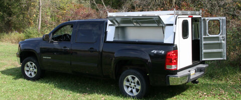

Contractor canopy for me for the last 10 years+.
Barn doors are way, way better than a tailgate with canopy lid, especially in a taller truck.
My front tool boxes are cut out, allowing a reach through for saws on top a built-in 4x4 shelf with bins below.
The rear 4x4 space has stacking bins and crates, with a side slot for long tools.
I have an shelf across the top of the canopy (taller than the cab by 4") that holds long, wide tools like rakes, and pole saws, KombiSystem, signs, etc.
