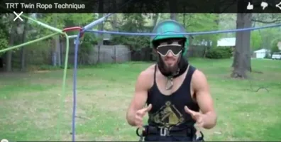

The video where Johnny pro explains the system and setting it up appears to have been removed, I did find a screenshot of that video that may help. 20190408_150349.webp
Two ropes are connected with a carabiner or screwlink, then each rope passes over a seperate limb, and comes back through the same carabiner/link. You can then pull on rope A or rope B while unweighted to shift where your ascent system is at along that plane.
His example in the video being that you could work multiple smaller trees that are between two larger ones. When your ready to work the next one, lanyard in slack the system and pull the carabiner over the next tree. Re-weight the system and swing to the next tree.
OK, I see that there is a lot more to this than simply running two ropes thru a single multiscender. Looks interesting, but does not seem much different than just using two DdRT setups. Maybe a bit less gear intensive but seems awkward if you wanted to completely retrieve one of the systems while still hanging on them and they were both captive in a single Bone or device.
Looks pretty awesome for the right trees... float the TIP wherever you want.
Is there any reason one couldn't set up like that up top but use normal diameter ropes and 2 multicenders?
The video where Johnny pro explains the system and setting it up appears to have been removed, I did find a screenshot of that video that may help. View attachment 58751
Hahha I went all through Johnny pro looking for this and saw it was taken down and was pissed
Nevermind. It'll get screwed up if not adjusting both devices exactly equally.
It might work out ok seeing how the system will be weighted. The tie in point might move an inch or two but just take slack from the other line if needed. Just use friction savers at both points to preserve the two anchor trees.
In the schultz effect there is a redirect that reminds me of this, two devices and the redirect point moves depending on which device is activated. If your redirect goes to far right, descend on the right system to swing it back to the left. I forget the name of the redirect or I'd put that in here, but it's a remote set, remote retrieve redirect that uses a second climbing system or a long lanyard.
That picture brought me back ....
I feel like the whole 120° thing is an elephant in the room with trt, but I love seeing people outside the box.
