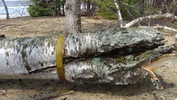

Tripping a Bore Cut
In the Fundamentals I didn't call it a "V" notch. But I did cite a similar cut I learned from a friend called the "Coos Bay"
It differs somewhat in that the quarter or side cuts are made steeper and deeper into the sides of the stem. And then finished with a cut into the tension wood.
The Coos Bay has worked well for me to trip heavy leaners minimizing splitting and barberchair, but it lacks any true directional control. the tree just goes where it wants.
And then again the tree has to be approachable to be able to execute the coos bay cut in the manner described. If you're reaching up or to the side then forget it.
Hard to beat a good cinch strap... or two.
Question....that looks like the cinch strap was on the stump..was there also one above the notch? I always thought you needed a strap above the cut.
This one was closer to the stump, the other was higher.
Thanks, makes sense...thought I was nutz for a minute (really longer than that).
