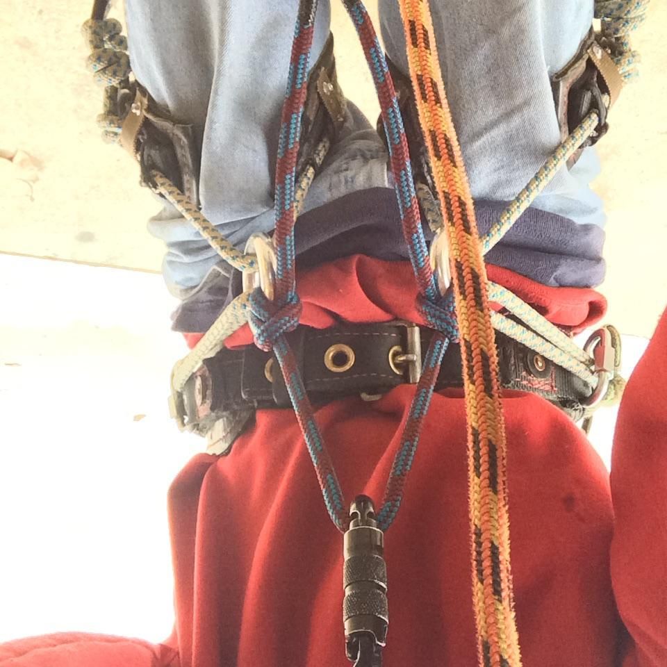

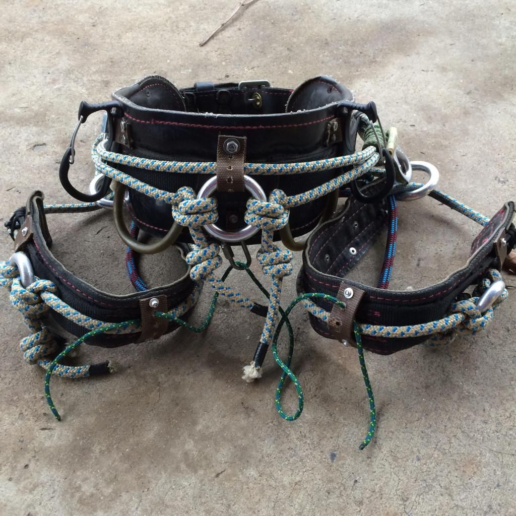

The harness is completely stock except for the D-rings mod.

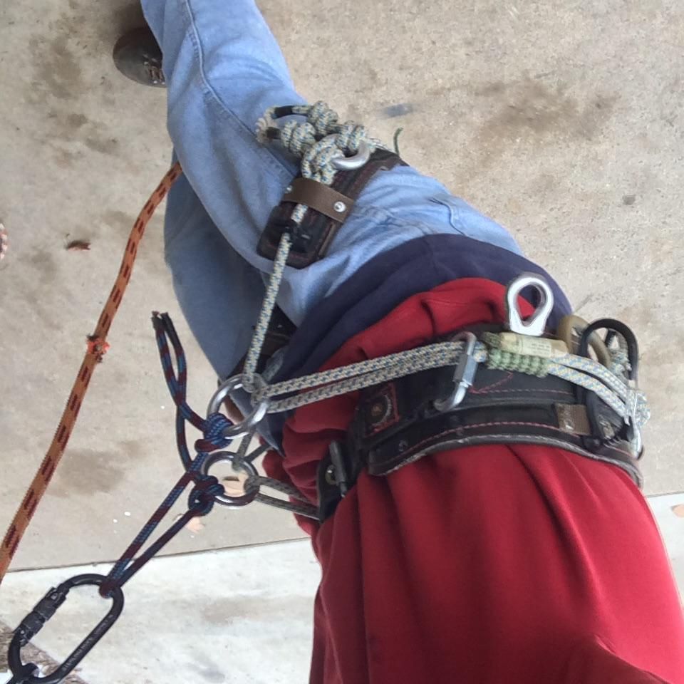

Under the yellow sling is a 1" black nylon webbing belt that is enclosed within the harness construction. The sling is attached to the belt with cable ties that go through the belt on either side of this black webbing belt. At the rear is a rated belay loop. I forced the sling up against the top of the loop and used 3 cable ties to pinch off the extra slack, and then I have a 5/16" SS bow shackle in the lower half of the loop. I use this to attach the tail of my long lanyard, because I don't like all the extra just hanging down. The idea behind using the rear belay loop like this keeps the yellow sling centered on the belt in the event that the cable ties should break. That actually hasn't been a problem, though. I believe that it would, however, prevent the sling from riding up and off the belt in a fall situation. All of the bow shackles have a piece of 3/8" air hose over the screw pin, which makes them fit snug in the loops.
I have since updated my saddle. I made the rear ring where the adjustments are made in a fixed position. I removed the side D's since I rarely used them. I placed quick links where the old D's were to keep the rope in place. This seems sturdier than having webbing with rivets where my upper D's used to be. Then I saw the photos that Matt has on his facebook and he has already done the same. This seems to work a lot better. O yeah, I am replacing my bridge cordage with something different.

I must say that to my eyes these harnesses look less then sleek. Do you guys feel that they have a technological advantage over something like the TM or are you making them for the self satisfaction of being able to custom make your own harness?
I hope this doesn't offend because that is not my intent, you have done good jobs, I am just curious.
In my experience these saddles have a greater mobility than the tree motion. They are slightly heavier than the treemotion. They are similar comfort although I would give the tm a slight edge but not drastically so. I don't know, a saddle is a saddle and they aren't that complicated and they don t need much to be more than functional. I like these rope saddles and playing around with them because they are so basic. It comes down to I would rather all my gear be made by me for me. That said I have been climbing on a TM mostly because of the ITCC
