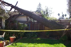

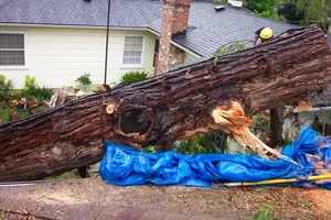

Last week I was at our California office last week and this tree just fell over at 6:30AM. No wind, rain, construction, etc. The house was being remodeled and no one was inside at the time.

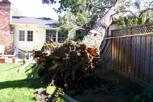

You can see at the root ball there are no roots on the right side (dry root). By the time I got there, the crew had already removed the brush and some of the top. The base measured 38" and at the gutter line was 25". The tree was in the neighbors yard and fell on our clients roof. The neighbor declined to pay for any of the tree removal.

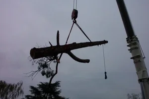

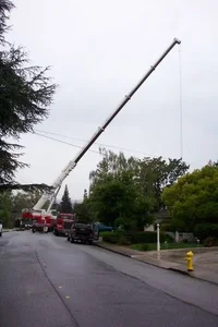

We figured the safest method to remove the wood was a crane. The farthest pick would be from 115 feet. We figured the weight of that pick would be 7,000 pounds. The crane company wanted to use their 200 ton Liebherr crane. They set it up in the middle of the street. 156' of boom is out in this pic. There was 1 more section if they needed it.

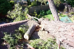

On the next pick, we were going to take the rest of the log out. The client asked why. "Can't you just take the log off my roof and lay it in his yard and leave it". So, that's what we did. The neighbor wasn't happy, but understood. He didn't want to pay us to have the rest removed. He said he was gonna cut it up for firewood. The species was Incense Cedar.
Norm,
What exactly is dry root? Is it a fungus of some sort??
you said before "no rain, wind or construction" but i wounder what has happened in the past to weaken the root system? Was there construction done in the past close to the tree? or the garden re-layed?
I take it there must have been a reason that the rootsystem has decayed.
Jelte
We used the pole clip to clip away from the window beneath.
When I said "dry root", I meant to say dry rot. Sorry. The right side roots were very decayed, plus the tree was leaning towards the house it fell on.

I used a cable choker with a ferrule and sliding hook for the spar of a removal I did with one of the guys from your Dulles office. It worked well. When I shopped around for this style of choker I found warnings that state they are not to be used for overhead lifting -- skidding only. Any liability concerns? Also, do how do you tie into the block when using a multi-part load line?
I was going to mention that it was a incense cedar and a nice size one to boot . looks like it got just a little to much watering over the years and couldnt handle it . MAkes good for split rail fenceing.
Greg
Looks like that to me as well Greg. Norm, do you know if that house used a sprinkler system for that green lawn?
I used a crane service for a while that liked the sliding chockers. It was a bit hard to use, but very adjustable. I'm only guessing here, but I wouldn't think that the sliding chockers used by so many crane companies would be "not for overhead lifting". I would assume that they are different than the skidding cable types?
Limbsurfer,
That choker was supplied by the crane rental company. I'm sure if they didn't trust it to lift objects off of a house, they wouldn't use it. I personally don't like using them. We prefer an eye & eye choker with a screw pin shackle, when we use wire rope.

I didn't notice any lawn irrigation systems at that residence, but alot of them do have it. Just because I didn't see it doesn't mean there wasn't one. As you can see in the pics, the lawn was long. More than likely there was one. I did notice that the base of the tree was in a low area. Water could have collected at the base of the tree.
