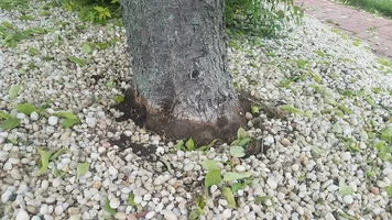

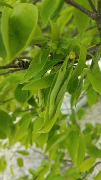

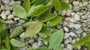

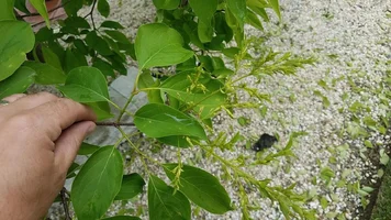

I was taking care of some other trees on this property last summer. The Japanese tree lilac was thin - the owner said it dropped many of its leaves in the spring.

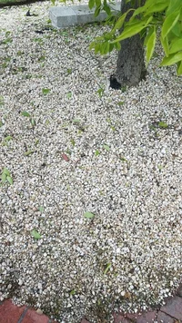

It is doing it again this year. I know: it is a little deep, and the fabric under the stones isn't helping anything out...but this looks more biotic.

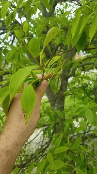

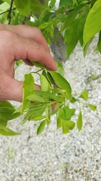

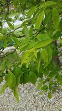

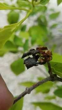

Notice also that some of the flower structures started to bud out, but have since wilted. Others look good. I scraped open a few twigs and didn't see any dark streaking in them. I only noticed the one group of dark leaves...everything else is green. When she called and told me about it this year, I wondered if there was a lilac petiole borer that I was unfamiliar with. I didn't see any evidence on the tree that would suggest this though...just the timing and the leaves falling off green but wilted.

I'm honestly not sure what this is. Thoughts? Thanks!
Try Pseudomonas. Also take a look for other contributing buggers like clearwing borer past damage
Not the leaf spot that I have been seeing more and more on these dudes, Psuedocercospora.
Elephant...if it's in the olive family...
Hmmm...plausible. The pictures I am finding online seem to have more leaf blackening. Sinclair and Lyon briefly compares it to frost damage as the infection makes the leaves more susceptible to freezing.
No sign on the trunk of borer damage.
I didn't see evidence of girdling roots, but we didn't pull back landscape fabric to look too hard. There is a top of a root flare and not an obvious flat side, so if there is one there, it is not going to be too bad.
Before I do a more significant RCX, I'd like to know what the disease issue is and whether that is something that is going to cause bigger problems than we can fix.
Could be many small things over time that are now starting to have an effect. What chemicals have been used in the lawn care? Watering schedule appropriate for species and soil type? Things like that can favor detrimental organisms and reduce potential systemic tree defenses.

Not that ya don't know this...lose the rock and fabric...mulch and flagstones for a walking surface. Ajuga or Thymus between stones will spread and looks pretty cool if they're interested in different design elements

Wasn't as deep as I expected. 2" down I found the tops of the main roots.

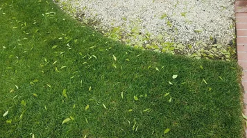

A lot more leaves down today. Just a few are off color. They are still very moist/pliable as they are coming off...not dry and crispy.
Samples sent to the OSU clinic.

I think we are on the way to changing to organic mulch. She doesn't like the stones. Also said they have more weeds here than they did at their old house with traditional mulch/no weed mat. Needs to consult with husband.
Maybe this is a better question for a new topic, but since we are here: If she wants me to do that, would you take out all the stones or just move them out of the way, remove the fabric, then rake the stones back out and incorporate them in with an airknife, finally top dressing with wood chips? They are mostly quartz, so should be non-reactive (at least compared to limestone!). I'm just imagining what a pain it will be to haul away a few tons of stone...and to where? Somebody would probably want them, but they'd probably want them washed first. They'd probably make digging and planting a bigger pain through the future.
re stones, I would not incorporate any on purpose.
