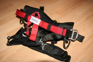

Here is one picture of the of the crappy sharp edged buckle. I bet that webbing doesn't last very long.

And this one is from the bridge. The protective tubing is too wide and the webbing underneath is stitched only once. The stitching is probably made from super Kevlar so they can work with only one single stitching row. By the way, the D-shackles were not tightened. It took no effort what soever to unscrew the shackles.

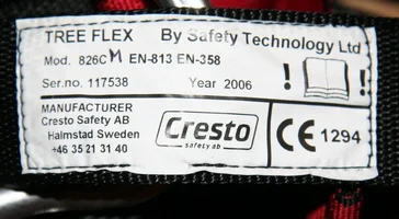

This is very important:
1. What colour is the 'TreeFlex' that you have ?
2. Have you paid for it?
3. What does the paragraph say with my name in it please?
Black/red

Just to keep the record straight, that harness is a pre-production prototype from 6 months ago. I can't begin to tell you how much has changed.
TreeFlex has not been OKd for sale! The harness you have is not the final version.
Auch, that sucks. I bought it as the final product at Poel.

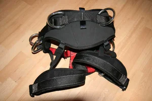

I've tried it on today at the climbing course (see attachment) and hope that the REAL FINAL product has at least wider/better padded legstraps, better buckles (not as sharp), modified D-rings (that will stay in place and not flip back all the time), better tubing on the bridge and accessorie loops that are more easy accessible.
I'm taking it out of service and will return it to the reseller to wait for YOUR OK'd PRODUCT.
