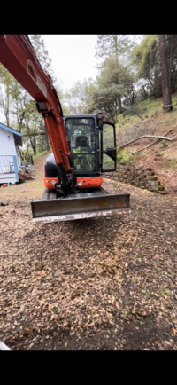

I do like the cleanliness of tour setup, @chiselbit . Mine’s a bit different as I went for the worm drive style. I was wanting the solid rotational holding power of it. I had to make the 45 offset to include the Bobcat X-Change coupler plate.
No offset, it’s just curled out or up in that pic. In any case I didn’t do anything to it, stock set up from kubota.it does bleed off like if I grab a log off center, if it’s big enough it will rotate heavy side down. Kind of a pain if I’m in the middle of something delicate like the other day ground man was trying to untie a rope while I held log up off of a retaining wall and it kept rotating down and he kept sliding down hill with it,, finally had to chase him off and bring it down to me rope and all.
