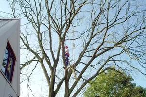

Ill post some of the tree.
This pic is from the entrance at the neighbours parking lot. Just wide enough between the houses to turn into it with my van and chipper. To small to get into with our tractor and trailor. So towmorrow we have to get a small dump trailor behind a van and pull that in....

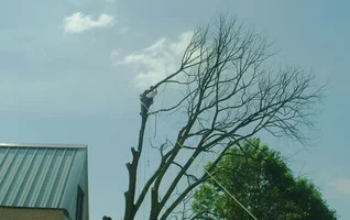

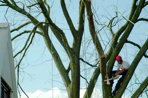

Here a pic as i installed the slide line and going for the first limb. Had to make a 'balancer' on the spot.
I set up the slide line anchor in a almost dead top at ø20cm wood. (sling with to D rings as anchor). On the slide line a pulley with carabiner to hold the balancer. from the pulley also a line trough one D of the anchor sling and down to the bolder. This line is to control the lowering and hoist the pulley back up. Down at the parking i put the line onto a manual winch to tension it.
(place balancer on limb, tension slide line, cut the limb, tension the slide line more, lower the limb over obstacles on the parking, remove balancer, slack the slide line, hoist pulley/balancer back up. and go again.)

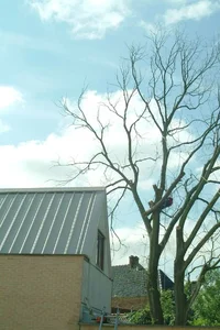

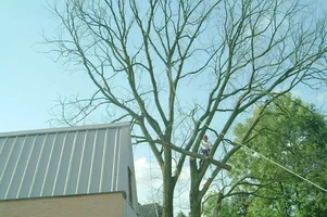

Another pic of that balancing limb

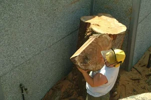

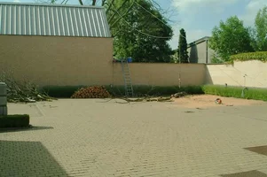

The parking lot where we chip and saw the limbs in firewood.
The slide line is attached to the van's trailor hook :) Fast giving slack and tension by driving <-> a capstan would be nice for this though.

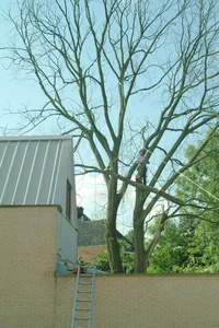

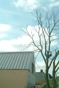

Topping the main trunk. Also last pic the groundie made :(
We got the limbs of today and the right big trunck down to the forkle. Towmorrow i lower the main trunk and finish up. Darn what a debri of dead branches came off...... took us an hour to clear the 2 lawns and roof of that garage....

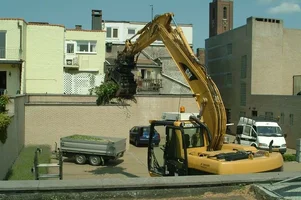

That small tipper trailor was half filled with chips of that tree and loaded on top full with all the sawdust and dead branches in 1000's of pieces. We got that crane to get the wood over the 3 meter high gardenwall
